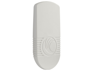

Yikes, you're using one of the orignal integrated radios? The ones that look like this:
I would swap this out with a Force 180 or 200. All these first gen integrated models were discontunued long ago... partly because their antennas are not very good.
