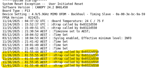

What does the message 'dtrap called by ...' in the Event Log mean?
Hi,
I cannot find any information on what the message ‘dtrap called by …’ in the Event Log mean.
Would anyone have an answer?
Thanks
Markus
Yes, this would be handy to know.
03/24/2026 : 00:00:00 UTC :
******System Startup******
System Reset Exception – Power-On Reset
Software Version : CANOPY 25.0.1 SM
Board Type : P15
Product Type : PMP 450b High Gain
Device Setting : 3GHz MIMO OFDM - Subscriber Module - 0a-00-3e-xx-xx-xx
FPGA Version : 110825;
03/24/2026 : 00:00:37 UTC : Spectrum Analysis due to CBRS complete for 12 seconds.;
03/24/2026 : 12:00:51 FJT : :Timezone set to FJT;
04/26/2026 : 17:37:54 FJT : :Time Set
04/26/2026 : 17:39:30 FJT : :Time Set
04/26/2026 : 23:52:47 FJT : :dtrap called by 0x0322ddd4
04/26/2026 : 23:52:49 FJT : :dtrap called by 0x0322ddd4
04/27/2026 : 10:14:44 FJT : :dtrap called by 0x0322ddd4
04/27/2026 : 10:15:44 FJT : :dtrap called by 0x0322ddd4
04/27/2026 : 10:18:30 FJT : :dtrap called by 0x0322ddd4
04/27/2026 : 10:18:31 FJT : :dtrap called by 0x0322ddd4
04/27/2026 : 10:18:32 FJT : :dtrap called by 0x0322ddd4
04/27/2026 : 10:18:45 FJT : :dtrap called by 0x0322ddd4
scracha, generally these are not a major concern, but I will reach out to you via one on one chat to discuss further
I’d be interested to know the outcome of that discussion, given that I started the thread.
Will do. and Markus, if you have any such recent complete log - a tech dump from cnMaestro or an engineering.xml capture roughly within a day or so of the dtraps being seen, do pass that along to me as well, thanks. There might be more additional engineering debug in such log above and beyond what is seen in the event logs posted by you and scracha
