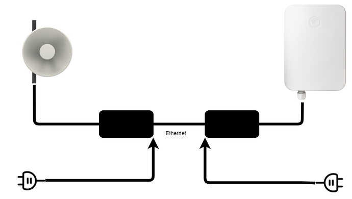

However, it should be remembered that the e510 has only one Ethernet port and to connect these devices you need a switch or a network bridge between the power supplies. Just like the following picture :slight_smile:

If you only connect 2 devices like ePMP and e510, it doesn’t have to be a switch…
You just need to bridge PoE power supplies
See the picture below. (left side ePMP - right side cnPilot)

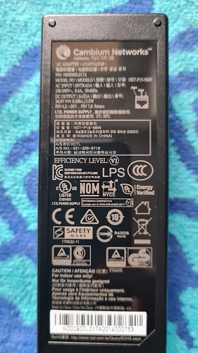

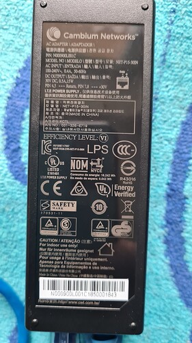

It is also worth remembering that the power supply for the ePMP is COMPLETELY different than the one for the cnPilot. Photos of the power supplies below
First for ePMP (this one comes complete with antenna)
The next one is a power supply for cnPilot (this one has to be ordered - not included)
Of course, as a colleague wrote, you can use Cambium switches, but unfortunately you can only power cnPilot with the ex version, they do not support 30V and you will have to power the ePMP device from a separate power supply. Hence, what I wrote at the very beginning.
