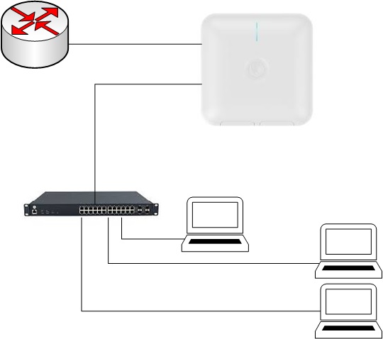

Hi Gupta,
THank you very much on this, another extra feature i learned..
so this network setup is feasible?
*see attached picture*
and also what SSID or WLAN this will be effective? if i have multiple WLAN / SSID?
thanks
Junar
HI Junar,
Yes, the network diagram you have shared is feasible. One which ever Guest WLAN you have enabled Extended interface that WLAN only will be extended to wired network.
