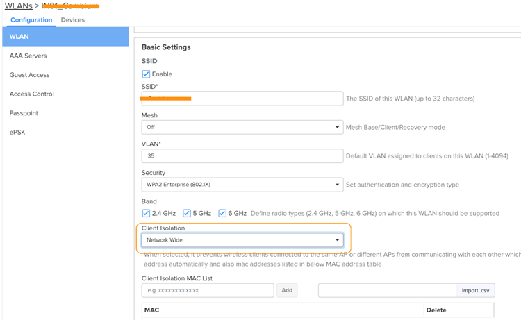

Enable client isolation with the Network Wide option to prevent clients communicating with other clients on the same L2 network.
Note: From the AP firmware version 6.6.0.2 onwards, AP drops the ARP packets when the client isolation feature is enabled. AP running with the firmware version lower than 6.6.0.2 can make use of client-isolation dynamic drop-arp cli from the AP group User-Defined Overrides section.

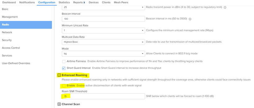

  • To avoid sticky client’s issue, enable Enhanced Roaming under AP group → RADIO configuration, set SNR threshold to 15 dBm

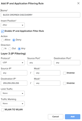

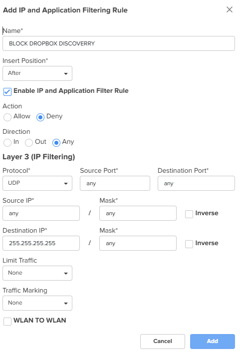

Thank you I have some question for this configuration, could please hlep me to understand this
  1. Could you help me to confirm my rules inputs value is correct under IP and Application Filtering Rules, I created one for BLOCK DROPBOX DISCOVERRY
  2. How to prevent un-authorized rogue DHCP server from the wireless clients ?
  3. How I could drop L2 broadcase packets ?
  4. How to Drop ARP discovery packets from one SSID to another SSID interface ?
  1. The rule is correct. However, please update the destination port from Any to UDP port 17500 over IPv4, which Dropbox uses for discovery. For reference, see the Dropbox documentation.
