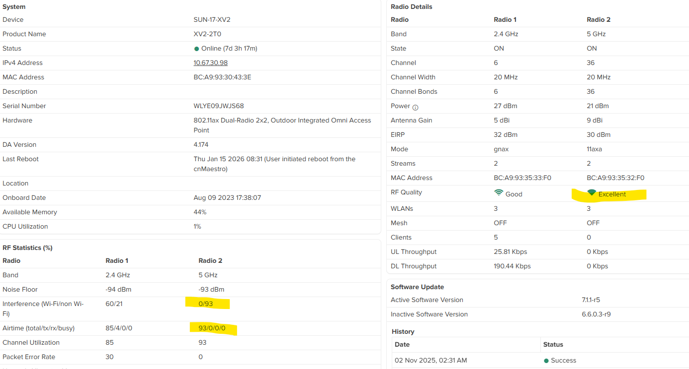

We have some outdoor XV2’s in a fairly large RV park. We’re starting to see issues with the 5GHz radio will show 90+ % non-WiFi interference and no devices will connect on 5G. At first, we thought it was external noise, but testing on some home routers in the park, the home router will not see the AP at all and devices will have difficultly connecting if the home router is on the same channel. Once we reboot the XV2, the clients will immediately connect to the home router. This seems to happen every few days and has happened on multiple XV2’s.
We’re thinking about reverting to 6.6 firmware.
