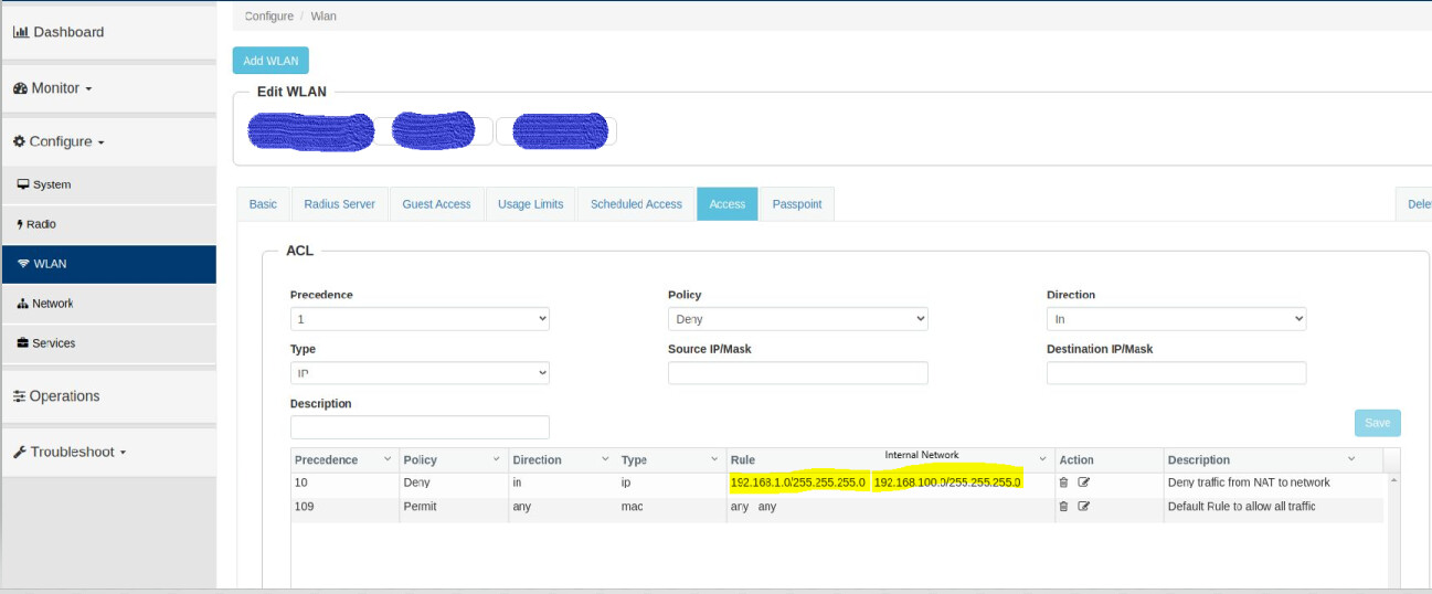

i have XV3-8 configurated one VLAN:
  1. Employees WPA2 intern WLAN key
  2. Guest (open Network) Internal Access Point.
Is the Guest Network automaticly isolated from our business network? Its safe?
Thanks a lot!

If you are using same VLAN as AP management VLAN, Guest clients can still access your network.

Ok what i can i do to deactived the access to intern lan?
The guest should just be able to surf.
1.Add additional VLAN in AP Group.
2.Create DHCP configuration for this VLAN
3. Set in Geuest WiFi proper VLAN number

  • Guest Access should be configured to OPEN and VLAN should be the one configured on AP.

i have one VLAN 1 and Pool1 for both WLAN’s. Thats right?

Last:
my view from deny ip adresses is differnet from yours:
What happend?
