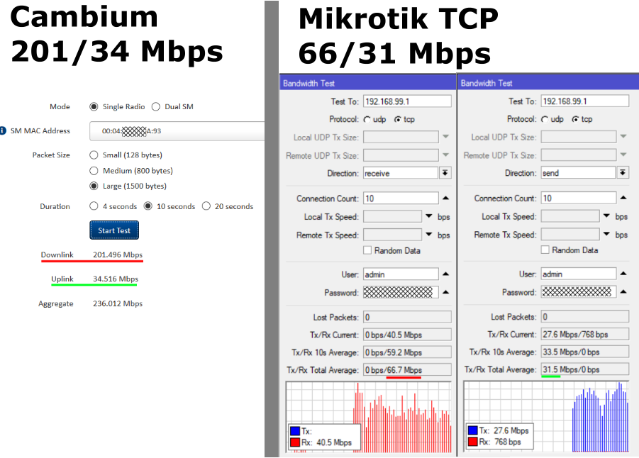

We are installing the first 3000 (AP & stations) but I can't understand why there is a slower TCP band than UDP
Ap has 40Mhz size, with 75/25 duty cycles.
The cambium test shows 220/35 Mbps, but when tested in multi-session TCP mode, the download reaches less than half, while the upload is at maximum (80/35Mbps)

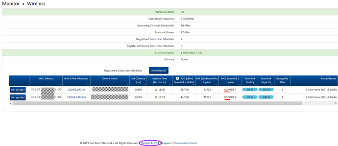

Everything makes the situation seem clean. The modulations always remain on the last ones (the best ones) and the retransmissions are very low percentage
Has anyone else happened?
(version 4.3.2.1)
Stations Force300-16 on ePMP3000
Test Cambium UDP vs Test Mikrotik TCP
Modulation statistics Downlink

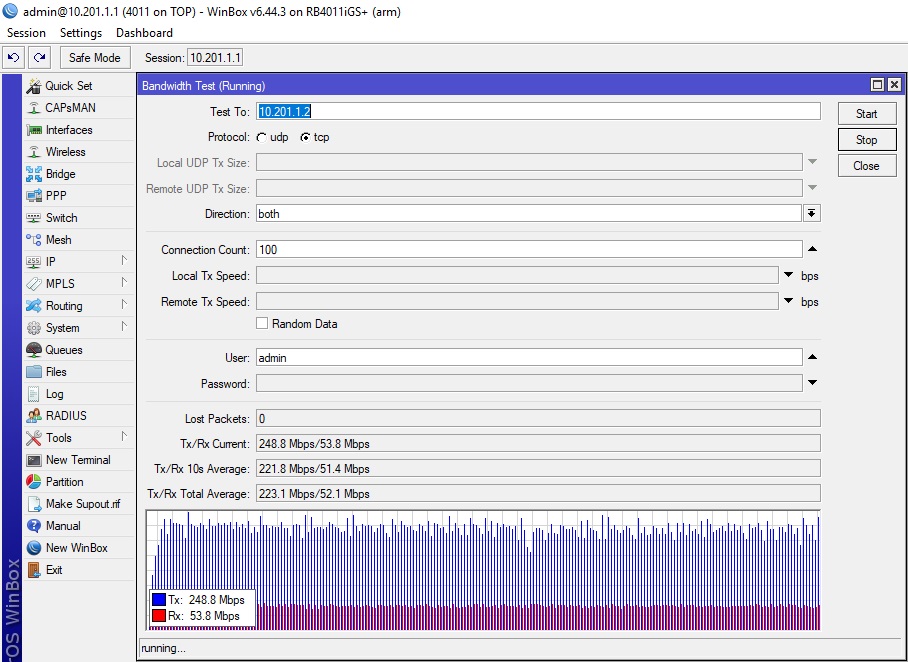

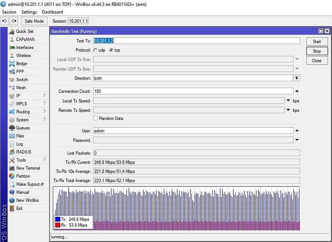

OK, I've just upgraded my ePMP3000's and Force300's to Version 4.4 (RC30) and I've done some throughput tests.  What I've done is to have a MikroTik RB4011 connected to the AP's ethernet, and another RB4011 connected to the SM's ethernet - so that I can test the real throughput that the ePMP Link is capable of carrying, using the MikroTik's test.  The RB4011's are running 6.44.3
So - first testing in 40Mhz channel widths with 75%/25% ratios, and testing in TCP, using the 'Both' (Bi-Directional at the same time) test.  This test was 249 Megabit download and 54 Megabit upload - so an aggregate of 303 Megabit per second in a 40 Mhz channel.

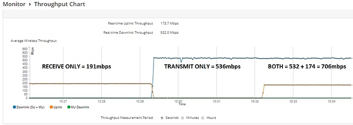

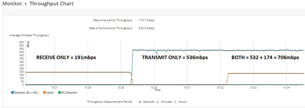

I also tested in 80 Mhz channel widths - although it clearly says "Beta Quality" on the 80Mhz modes.  For this test I wanted to the one-way 'upload only' and then the 'download only' and then to also do a 'both' Bidirectional test.  In the following image, this is showing the AP's throughput graph - showing how much sustained traffic it was carrying, while the Mikrotik 4011's were doing their tests through this link.
This is 80 Mhz channel with 75%/25% ratios.
The Upload only test was 191 mbps (25% ratio)
The Download only test was 536 mbps (75% ratio)
The 'Both' Bi-directional test was 532 + 174 = 706 mbps aggregate
