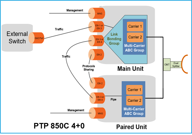

We are currently trying to do this with 850C’s. If I have both radio’s configured as 2+0 do I have to do anything special to connect them to make it 4+0 or is it already there by definition?
Hi Dillon,
You need to cable the two radios per required by the installation guide, you can also refer to the technical description document, both are available from the cambium website. Then you need to configure one of the radio and main and the other radio as mate. You can follow the quick config - also please refer to userguide.
