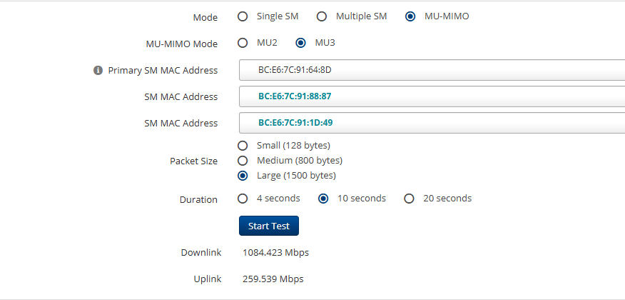

5.11 has been a game changer for me.
What have you seen? What issues where solved for you?
We experienced significant stability issues such as repeated base station reboots and client stations losing authentication while still remaining associated to the base. The only way to fix it was a hard reboot. MU-MIMO was also not functioning as expected either and causing various issues when enabled.
After updating, MU-MIMO is now operating correctly and both the base and all connected client stations have remained stable, with no further authentication drops or reboot events observed.
That being said, every network is different and this is my experience. above is MU3 at 80 mhz. This base station has 51 connected stations.
