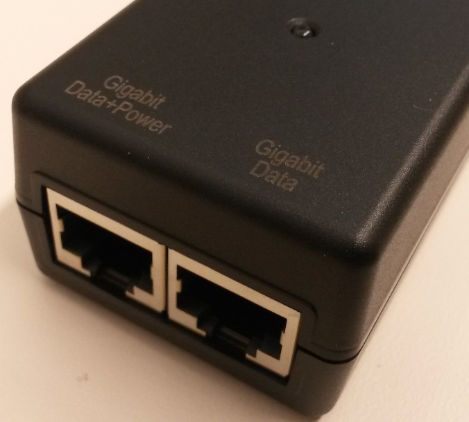

with the new POE there are multiple ways to screw it up.  when they unplug everything the labels to put it back are "Gigabit ethernet" and "gigabit ethernet+power".  so which one is supposed to go where?  well power seems "better", maybe that goes into my computer...nope wrong.  but even better labeling won't help a whole lot because once they unplug the cables they usually toss them or do god knows what with them.  so here's the support call:

catch my drift?  labeling would help a bit but honestly there's 6 points of failure on the new POE (2 ethernet ports and 2 sides to the power cable, plus the ethernet ports can be plugged in backward so really it's 6 things to check)  the old POE has 3 points of failure. is the ethernet cable from the radio unplugged?  is the wall wart unplugged? is the flat black cable unplugged?

TO RADIO (Data + Power) (With a ! in a triangle to be scary warning)
TO PC/ROUTER (Data only)
Seems like the best labelling I've seen.  WAN/LAN labels mean nothing to muggles.  IN OUT labelling can be similarly confusing (though its close if you think of it as INSIDE OUSIDE).  Some used to say CPE and customers had no clue what that was.
Adding color codes doesn't hurt either, yellow does seem to be the closest thing to a standard.

I agree that the potential for confusion is high - but the solution is really simple:
Cambium could issue a revision of the units with "TO RADIO", with a yellow exclamation mark in a red triangle, either printed or on a sticker by the OUT port. The installer would affix a label with "FROM RADIO" and a matching symbol to the cable to the radio. The other port, to PC, would have a similar label on the injector, but just a blue square. The installer would be able to make or buy a pre-made "standard" blue patch cable.
This would cost, what, 2 cents per unit on this kind of scale? It's a couple stickers and a zip tie :)
Hi,
I only have one complaint about the new power supplies over the old style.
Please please please...change the silkscreen print to something old eyes can see....puke brown on black?!??! i dont want to use an arc light and magnifying glass to read!   that is all carry on epmp is good stuff!
+1 for white on black.  And bring back the yellow triangle of powered doooooooooooooooooooom.
Use a different colored patch cable from the gigabyte/data port. problem solved.
