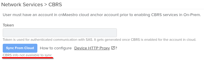

Has anyone had any success setting up CBRS to work with a new on-prem instance?
I have my on-prem cnMaestro server set up and connected to an anchor account.

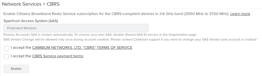

I’ve set my anchor account as a secondary account to our primary account and shared the SAS ID with that secondary account.
I cannot get the on-prem instance to pull down the CBRS SAS information.
In the cloud anchor account, I see the agreements not accepted yet (main instance is working)

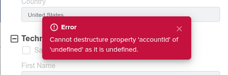

But if I try to accept, I get an error:
Cannot destructure propery ‘accountId’ of ‘undefined’ as it is undefined.

As far as I can tell CBRS currently cannot operate independent of Cambium Cloud, the on-prem instances run billing and possibly proxy through the cloud. It should be possible for me to move all my devices to an on-prem cnMaestro, even with CBRS running through the cloud. But I can’t even do that due to the error I’m getting.

You can bypass the “CBRS info not available to sync” if you are comfortable mucking with the database directly, along these lines on your VM, replacing the ##### with your CBRS token:
sudo mongosh --quiet "mongodb://127.0.0.1:27017/stats" --eval '
db.getCollection("cns.system").updateOne(
  { cid: "cnmaestro" },
  { $set: {
      cbrsTokens: [{ key: "#####", ts: Date.now() }],
      cbrsState: true,
      cbrsStatus: "Active",
      cbrsTs: Date.now()
I am not recommending this approach. It is probably 100% unsupported and may void some terms or what have you, but it may be a last ditch option. Devices registered on-prem after that sync back to the cloud anchor from a cnMaestro/Cambium licensing perspective, assuming you share billing/SAS with your cloud anchor as a secondary account to your primary cloud account. CBRS registration stuff works like normal in the on-prem version. This routes everything through sas.cbrs.cambiumnetworks.com, which is the CBRS domain proxy, so it only gets you partway there. The local on-prem cnMaestro will let you continue managing existing radios as needed even when cloud access is unavailable locally, assuming they are not already registered with a cloud account. I do not know if you can add new devices once the cloud goes down. And if/when that SAS URL shuts down (certificate is good through March 2027, but hosting, who knows…), that’s when CBRS definitely kicks us off. Further, if cnMaestro billing ends, the domain proxy (which basically does license/billing checks before talking back-and-forth with the SAS) will likely stop passing requests, too, even if it still happened to be running after the cnMaestro cloud shut down.
