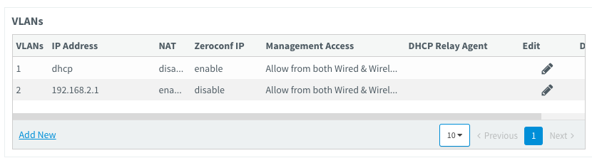

1.Firstly we must create a DHCP pool which is found under ‘Network’ of the AP Group we are configuring.
2.Once the DHCP Pool has been created we need to assign it to the VLAN we decided upon earlier. Go to VLANs under Network for the AP Group settings.
3.When setting the new VLAN set the IP address to static using the first usable address from your DHCP Pool and the same sub netmask. Ensure the NAT option is selected.
