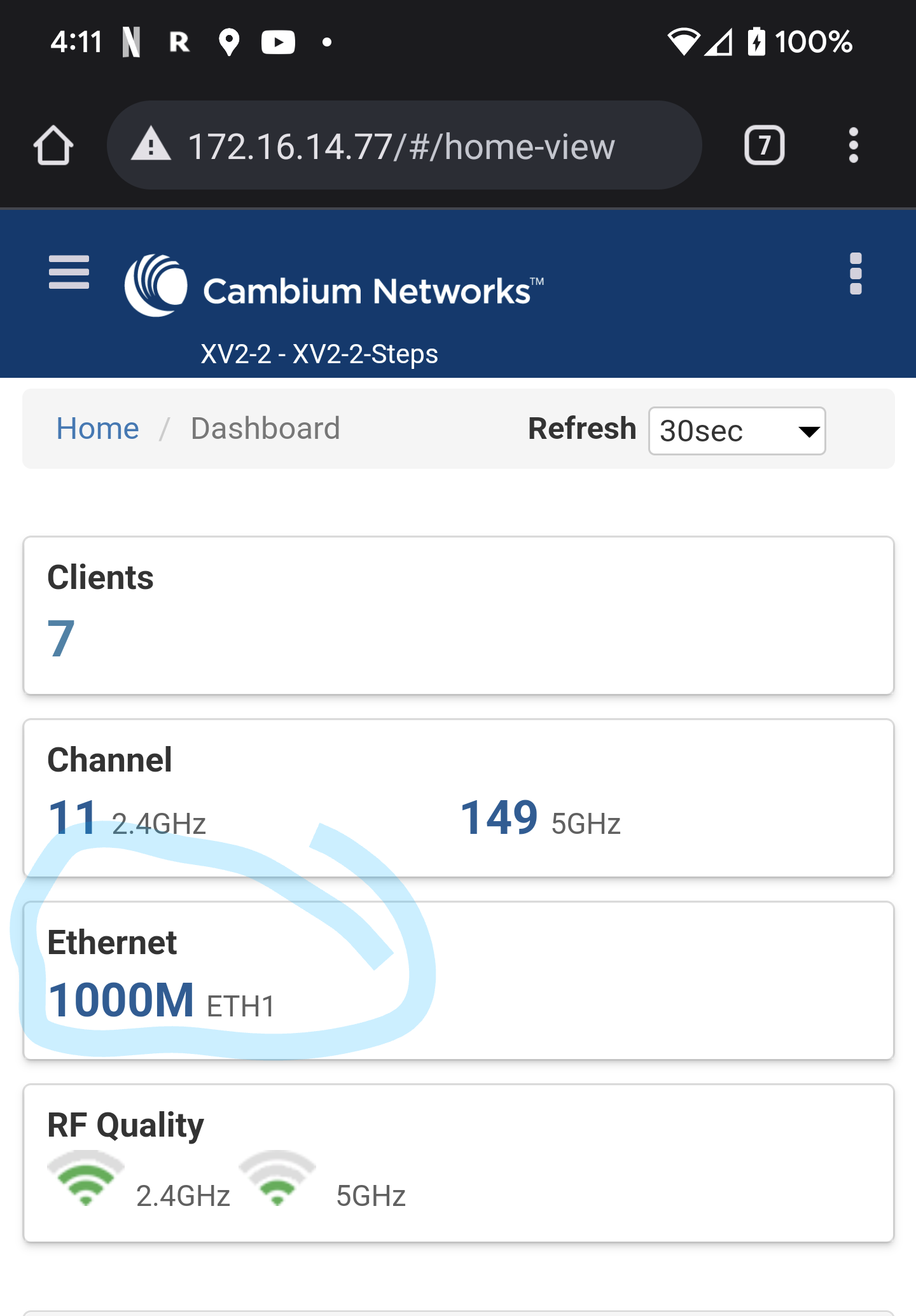

Look at the E410 connection and see if it reads 100M. That would explain a 90 Meg download speed.
Where exactly I can look for it?
I am sorry, but I can’t find any page such that one.
That’s the webserver on the access point.
Yes, It shows Ethernet 100M. Is there any chance to change it?

Based on what you’re telling us, it sounds like the e410 and the cable modem are only communicating at 100mbps. By default the e410 will try to communicate at 1000mbps automatically. Perhaps try a different port on the cable modem, or a different ethernet cable, or an intermediary (like a gigabit ethernet capable switch) between the e410 and the cable modem.

You’re seeing the proper speeds most likely because the gigabit ethernet port on your laptop is communicating at full speed with the cable modem. Again, I believe that the e410 is having some sort of negotiation issue with the cable modem which is limiting speeds to 100mbps or less. Try using a gigabit capable router or switch between the cable modem and e410 and report your results. ALSO, it would be helpful if you gave us a screenshot of the dashboard page of the e410 connected to your cable modem.
