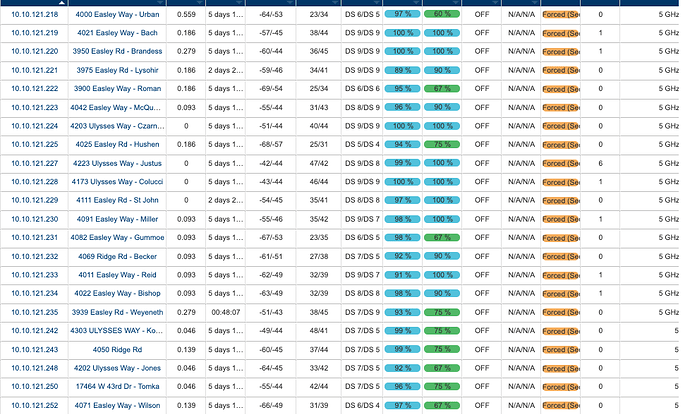

Here's some data from our antenna change. We started with a 3K AP on the KP Performance MU-MIMO omni antenna. This is mounted on a mini-pop house serving 21 clients.  We were not happy with groupable SM numbers, the MU-MIMO performance or the RSSI numbers. I suspected one of our problems was most of the customers were below the optimal vertical beam height of the omni. The AP sat up on a hill and the clients were all below.
Here is our Monitor screen with the Omni (sorted by IP):
After changing to two 90 degree (symmetrical) RF Element horns pointed off axis (to get 180 degrees of coverage), here is the Monitor screen:
Note the increase in groupable SMs and an across the board increase in RSSI and SNR for all SMs.There are still 5 old N clients on this AP (the last 5 in the list) that we have not gotten to changing out yet.

All devices are running 4.5 release and the AP is set to "split sector / Omni" for the antenna.  I'd like to think after upgrading those last 5 SMs, we can work on getting some better MU-MIMO groupings. Interested to hear some feedback from Cambium on those numbers, especially the two showing 13.
