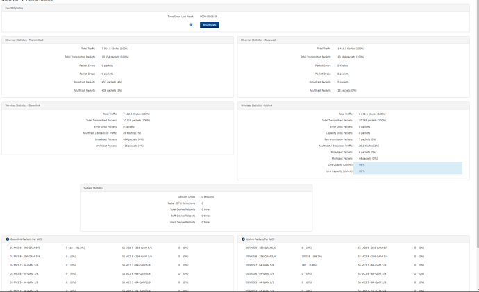

Could you please attach Monitor Wireless and Monitor Performance screenshots?
Thank you.

@Fedor, so you want everything on those screens, or something specific?
I would like to see distance to SMs and Wireless statistics, like retransmission rate and packets per MCSs distribution.
Thank you.

Your first pic shows you have a ton of download and upload interference. That SM will most definitely have higher ping and latency. Locking your upload MCS rate down will help some.
Hello, thanks for reply. We just made it with Sebastian from Cambium. Let see how it works. Thx again.
