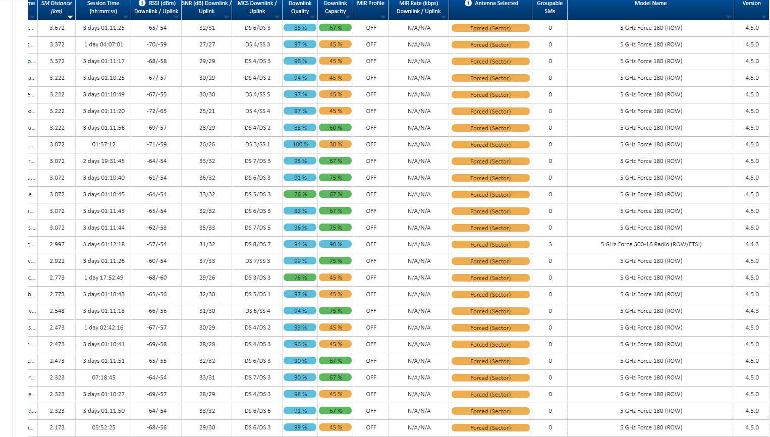

Hi Chris_2;
That's very good.  I noticed that some of your SMs are running different firmware versions.  Would that make a difference?  Also, you're not using MIR Profile based on the screenshot.  Would that make a difference?  Also, what are you using to do put customers to their various packages?
That is some good SNR.   Are you using the Beamforming antenna?  Are you using the ePMP 3000 AP stock antenna (Cambium's version) or another 3rd party, like a horn or something?
Very good results.

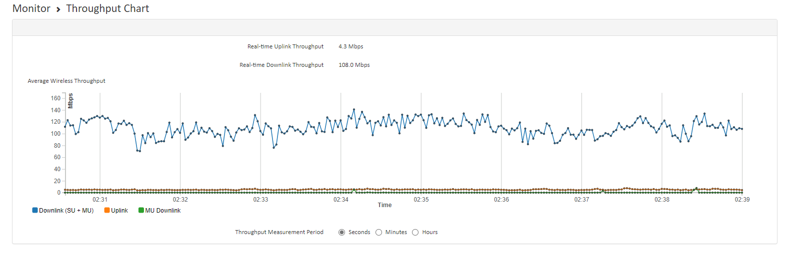

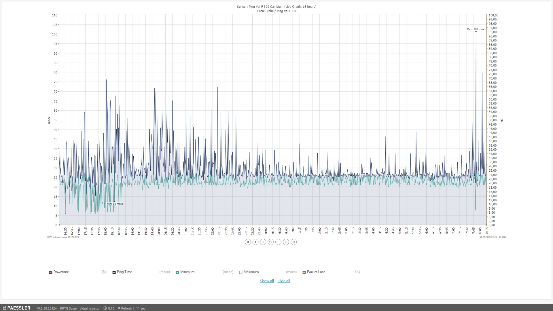

i want to share my results too.
64 clients
Hi,
These are good results with e3K running backwards compatibility mode. I noticed that most of our SMs are still 11n. As you change out the SMs, I think you will see considerable improvement in AP tput and DL MUMIMO results. You should also make sure all the SMs are on the same software version.
If you don't mind me asking, what is preventing you from upgrading the SMs?
Thx
Sakid

I see that all your sm are force 180 and with distances above 1.5 km, which model of ap do you use? what kind of antenna do you put on it?
Another thing that I see and I create that data in case 100% improvements are not achieved are downlink capacity
thanks for showing us your network
regards!
this antennas with 4.4.3 are comming from other ap working on this version. cnmaestro update this versions one time a week. :D
