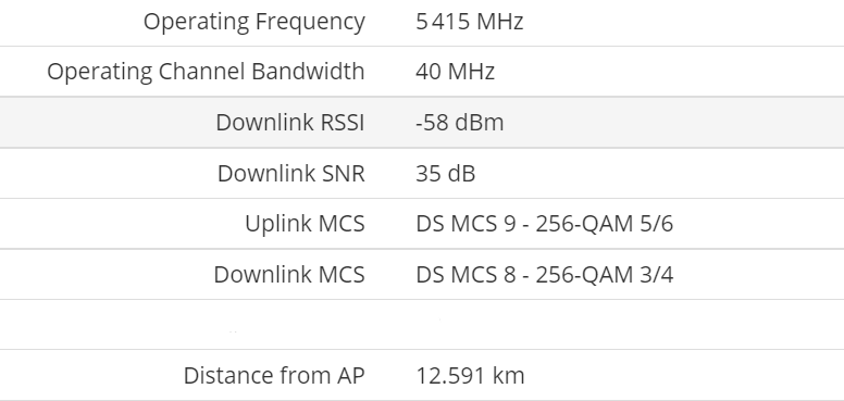

Hello to the community, has anyone already established a 12 km link, if so with what type of radio?

Thanks very much ! I have 300-25 in stock.
Force 300Csm with 30dBi antena
