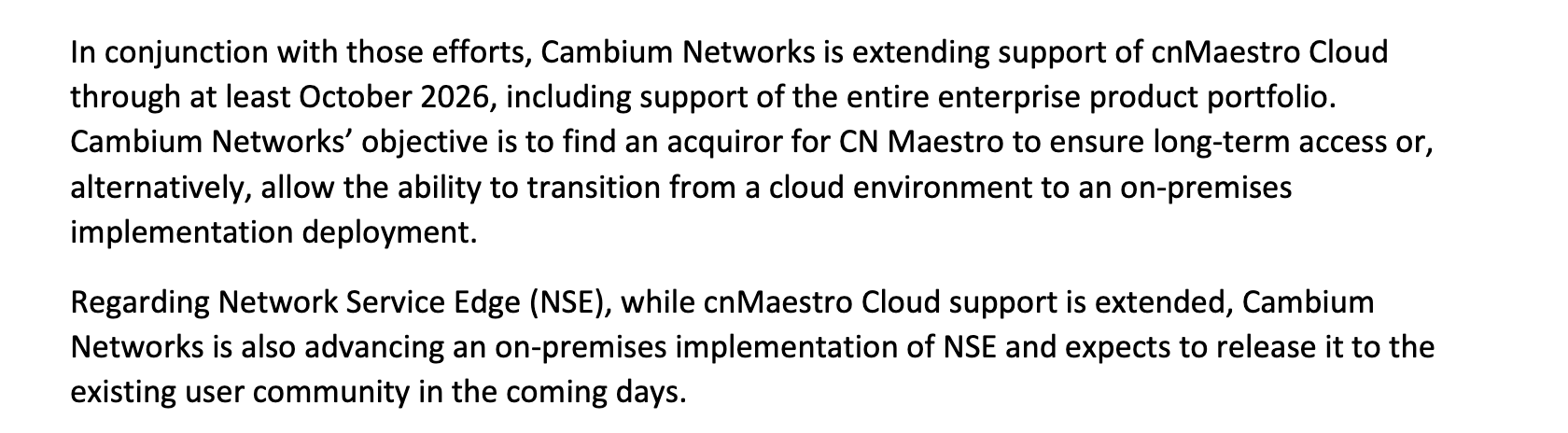

Any updates for us Enterprise customers who’re waiting the fate of cnmaestro and our enterprise hardware?
  • Can Cambium give info as to the next expected cnMaestro on-prem release
    • Will the release really support NSE?
    • Will it be full featured - “unlocked/unleashed”?
  • Cambium executive team took all our subscription and hardware money, we will never be made “whole”
    • No ability to RMA, no more TAC and no CCAV.
      • This is reason to release full “X” on-prem - no pay walls, as if the cloud anchor goes away we lose all entitlements.
    • Without Cambium maintaining cnMaestro - we’re one large CVE away from chaos…

I’m afraid NSE3000 devices are not supported in On-Premises:
@Simon_King
This contradicts the prior Cambium release… Cambium just stated NSE support WOULD be added. has this now changed, if so - can you have administration tell us? This is bullshit.
So what is it then, has there been a deviation in the plan? Administration has been silent.
