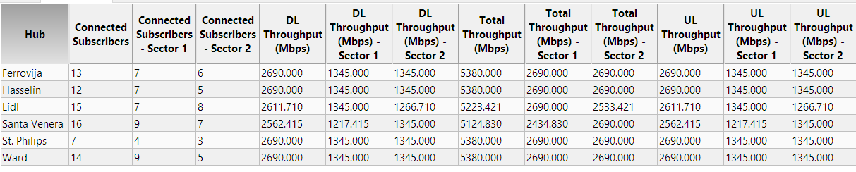

On the V5000 the Performance is shown independently for each sector as well as the aggregate and under PMP Links Access Points the number of clients and throughput can be shown per sector as well as the total.
