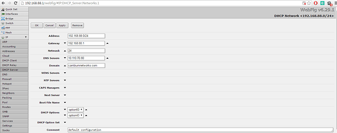

Now assign each set to a different network you want to assign for each device type from the Microtik Router
GUI by navigating to IP->DHCP Server->Netwroks page.
Interface , Bridge and Port settings needs to be done prior to creating the Networks in the DHCP Server settings
Find below GUI side configuration for Network as well as DHCP options. But the options are not configurable from GUI as there is a data type error coming which is an issue with the Microtik Router. Tried with versions v6.29 and 6.3 but didn’t work. So configure the DHCP options from cli , Once configured from cli it is reflecting in gui properly.so it is adviced to configure from cli the DHCP options and then map them to the DHCP network from GUI.
