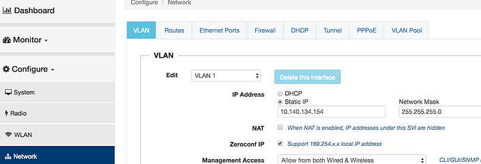

pre-onboarding it would be on the AP itself (log onto the AP GUI and change the IP address under the interfaces vlan). In the GUI this is in Configure->Network->VLAN. Screenshot below:

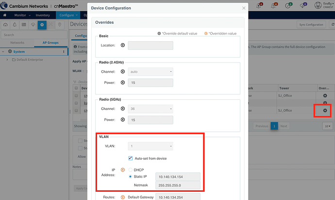

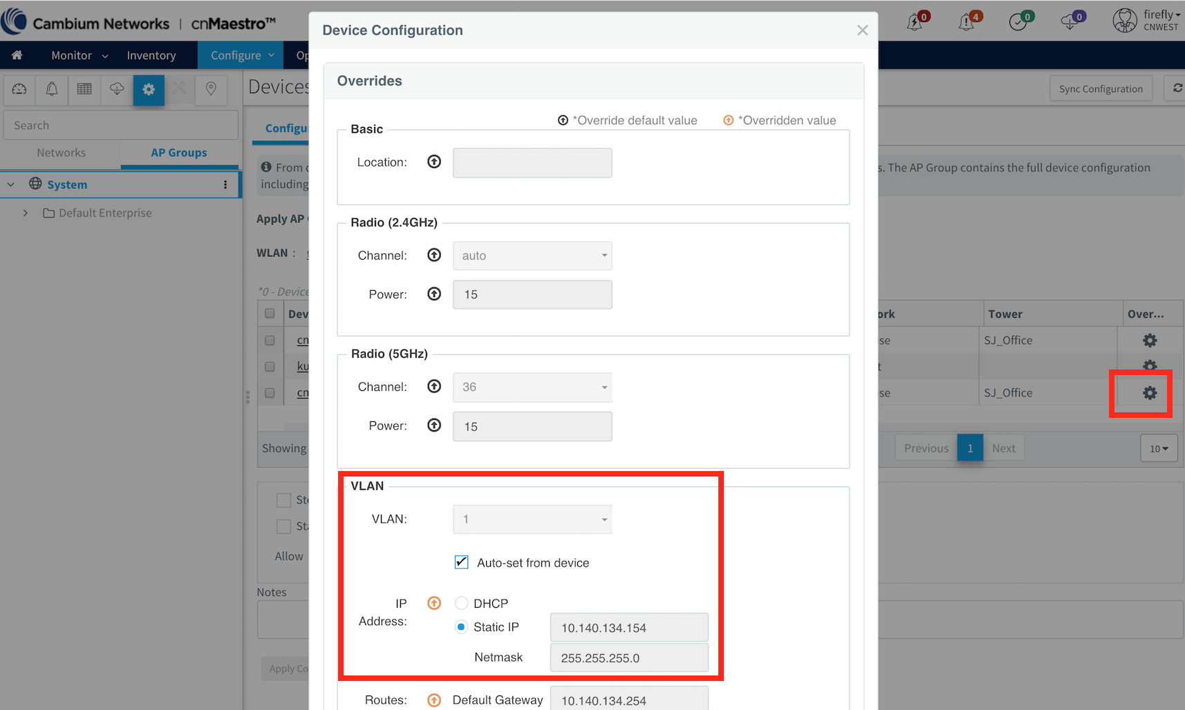

Once onboarded and configured, cnMaestro has an option under device-overrides to set per-AP parameters. So under the device configuration click on the little icon for overrides and in the pop-up you'll see an option to set the IP address of the device. the IP can also be setup to be learnt automatically when the device connects to cnMaestro.
