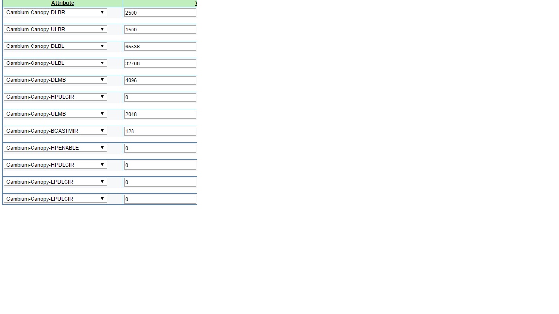

I actually updated the VSA just after my first post and the new paramaters seems to work without issues... I hope :)
Anyway , I'll capture you guys more information when I run into the issue again.
Sending Access-Accept of id 0 to 10.25.26.141 port 1235
Framed-IP-Address = 10.4.27.189
Framed-IP-Netmask = 255.255.0.0
Cambium-Canopy-Gateway = 10.4.0.254
Cambium-Canopy-DLMB = 4096
Cambium-Canopy-HPENABLE = Disable
Cambium-Canopy-BCASTMIR = 128
Cambium-Canopy-ULMB = 2048
Cambium-Canopy-ULBL = 32768
Cambium-Canopy-DLBL = 65536
Cambium-Canopy-ULBR = 1500
Cambium-Canopy-DLBR = 2500
Cambium-Canopy-HPDLCIR = 0
Cambium-Canopy-HPULCIR = 0
Cambium-Canopy-LPDLCIR = 0
Cambium-Canopy-LPULCIR = 0
MS-MPPE-Recv-Key = 0x0dc87229463be7a66db652fa480ad0bf7b7d895ec50d97624833ba8d9318590f
MS-MPPE-Send-Key = 0x5435bc517ac5650370351ac34b90310f8e5a58354228ede284e9dc1b0e439be7
EAP-Message = 0x03050004
Message-Authenticator = 0x00000000000000000000000000000000
User-Name = "anonymous"
