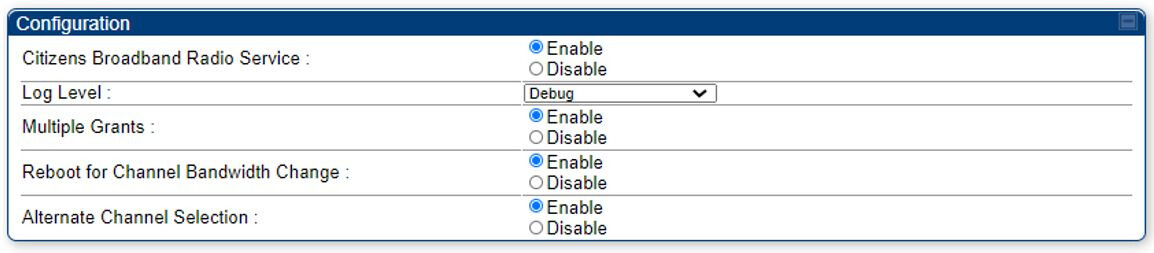

In System Release 20.1 and prior, the device asks for a single grant regardless of the channel Bandwidth the device is configured for. If a single 10 MHz channel needs to be terminated (for example, a PAL is now protected on that channel), or suspended (for example, a DPA activated on that channel), currently the entire wider channel is affected.
With System Release 20.2, the device has a configuration option to ask for multiple 10 MHz grants
The below figure dispays this configuration option on the AP. Impacts to other UI images are shown in the Configuration Guide and the CBRS Consolidated Procedures Guide. Details on how to use the feature are detailed in the CBRS Consolidated Procedures Guide.
Two other configuration options are also introduced, and their purposes are explained in Configuration Guide and the CBRS Consolidated Procedures Guide.
