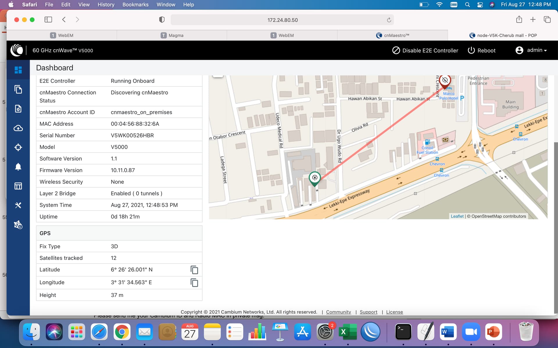

However, I have a challenge managing an onboard e2e controller as its stuck at discovering cnmaestrro for over 48hrs as seen in attached.

The V5000 is mounted on the tower and connected to a router.
Attached here is the traceroute to cnmaestro IP from the router
Hello @Lepakshi_Maheswar_Ra
The v5000 eventually got boarded on cnmeastro without making any changes.
However, the topology did not sync on cnmaestro as seen in the attached

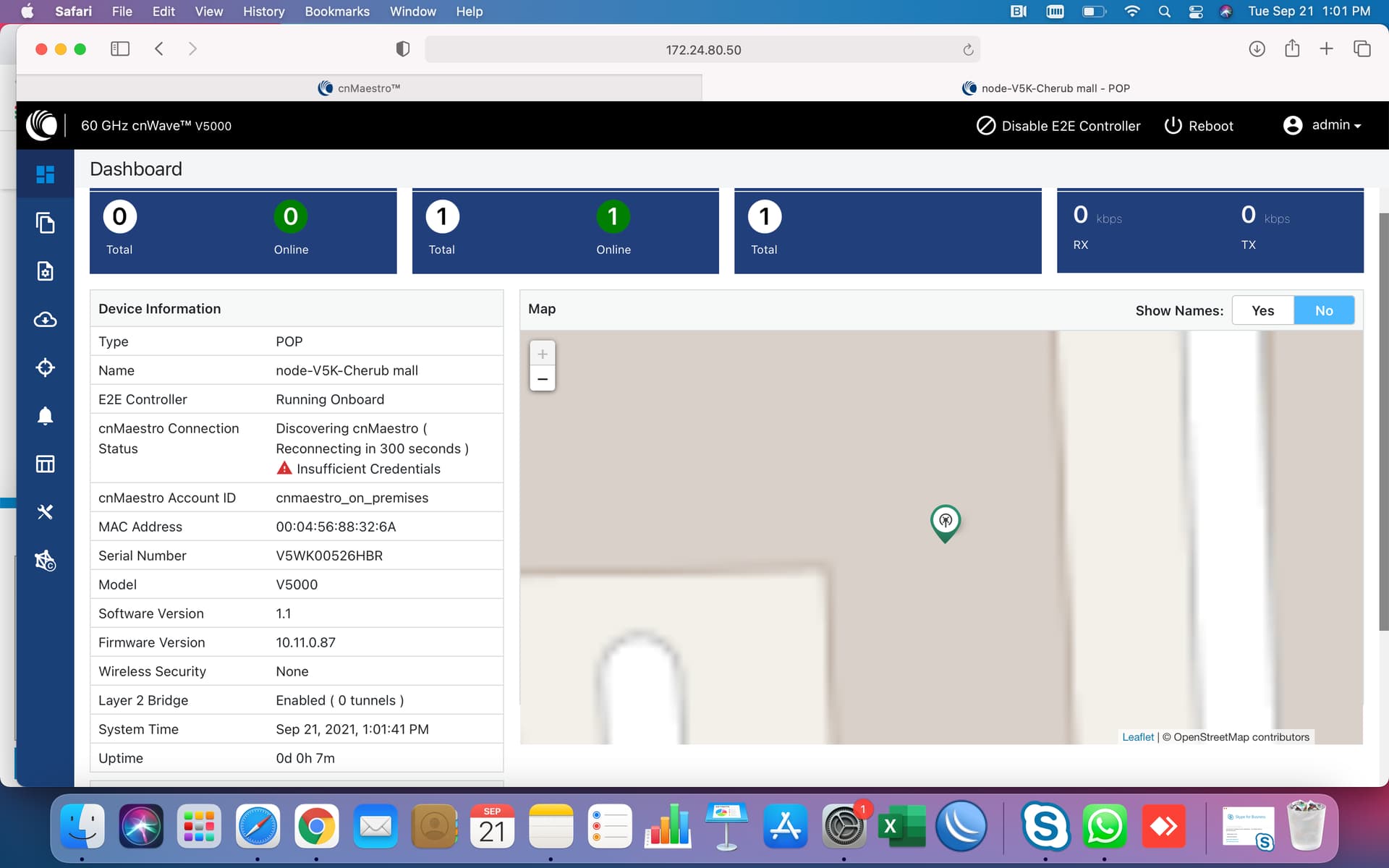

We can see the reason why topology sync is failing when we hover on the info icon in Topology sync error. Also can you download and send DA logs from device UI
The topology sync error was duplicated MAC. So I deleted the duplicated NODE MAC and then rebooted the v5000 via GUI. But the v5k is back to insufficient credentials error after reboot as seen below.
da_logs_88326a_1632225669473.txt (6.5 KB)Its now onboarded after i re-entered the onboarding key.
