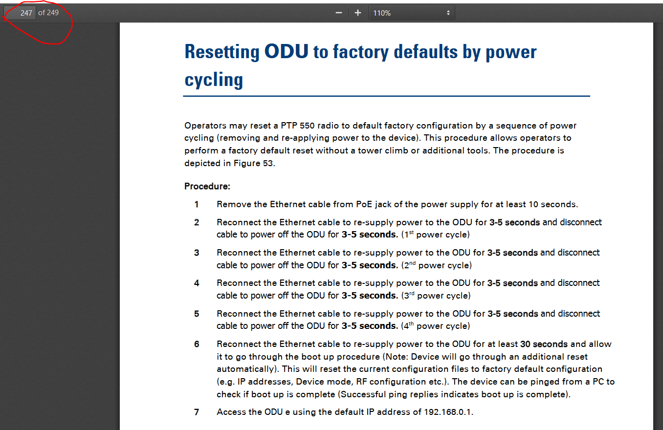

Maybe try this
Hi…
Thanks for your response.
I was followed and checked with the same procedure but no result.
Is any other way to reset the device??
BR//
KNReddy
Hello Nagarjuna,
The reset steps are found in the “CambiumPTP 550 Series User Guide System Release 4.1.2” available on the link:
Let me help you with the PTP 550 reset. Follow the step below:
  1. Hard reset procedure
  1. Power cycle reset steps
I believe this will help you well.
Sincerely yours,
NIRAGIRA Olympe

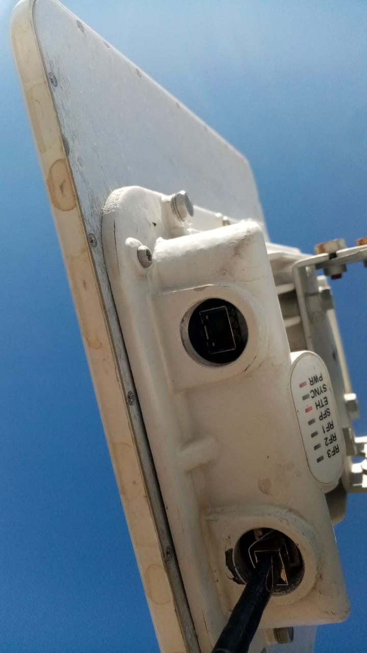

Factory Reset by power adapter was resetting years ago.
Cambium devices have many manufacture provider, so not have the same specifications
Cambium ptp 550 factory reset button in sfp port
brother, did you try and succed?
