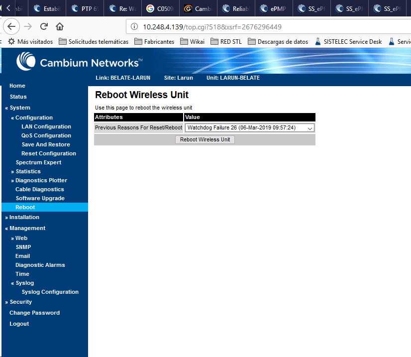

we have had today reboots in all our PTP650 units because a Watchdog Failure 26. Al our units have the latest 1.47 firmware version and are managed from CnMaestro. Do you know which is the reason of the reset?

This evening I had 3 of our PTP650 links reboot on their own. When I went into the Syslog on each master unit, I found: Kernel Warning event; cold_start; PTP wireless bridge has reinitialized, reason=Watchdog Failure 26
