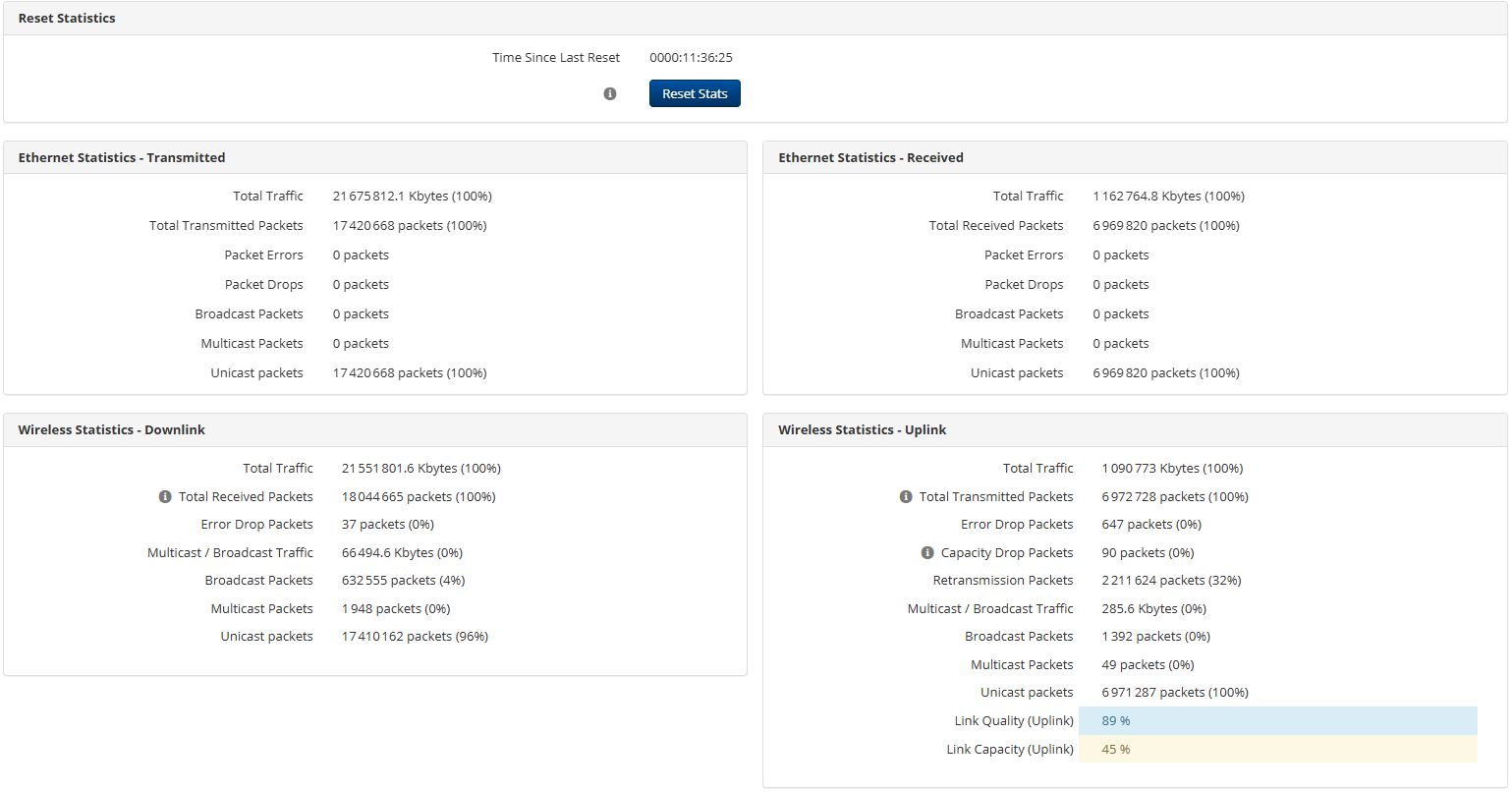

Retransmissions,Ping,Jitter
What Could Be The Problem ? Uplink Interference ? Or What ? Dirty Channel ?

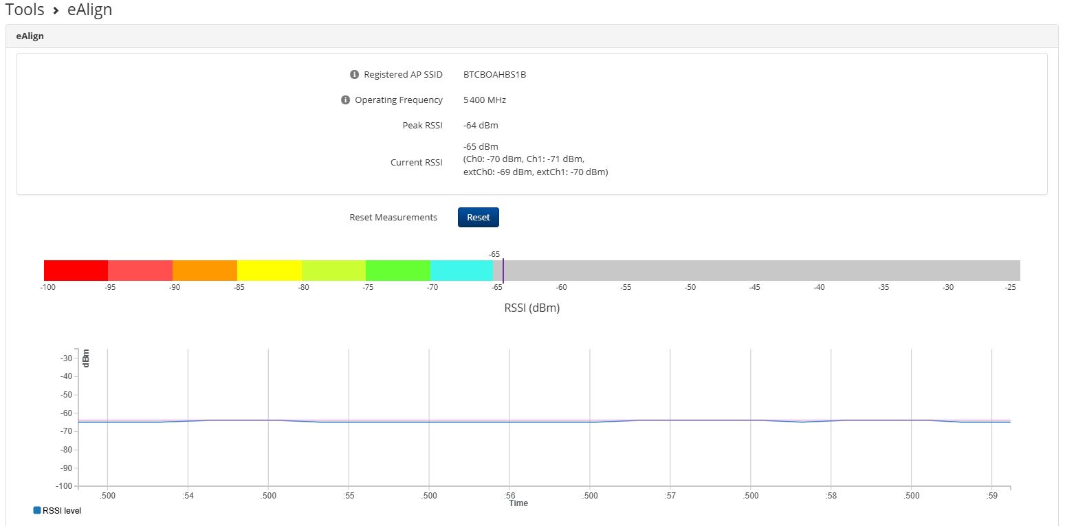

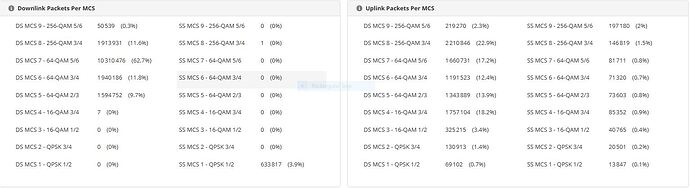

What problems are you actually experiencing with the link? From everything you’ve shown, this link doesn’t actually look too bad.

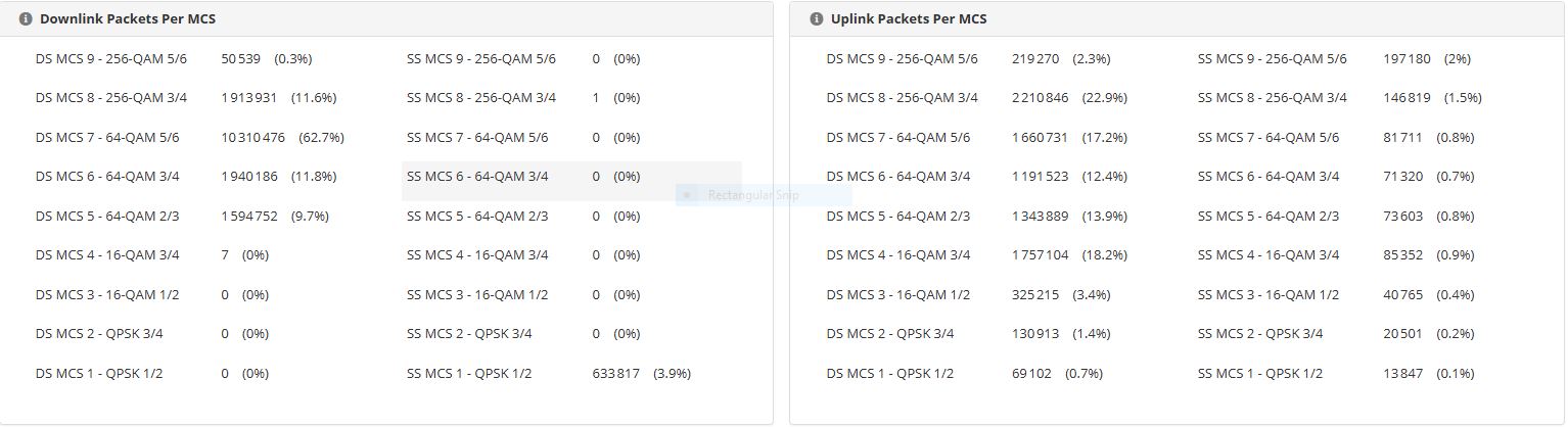

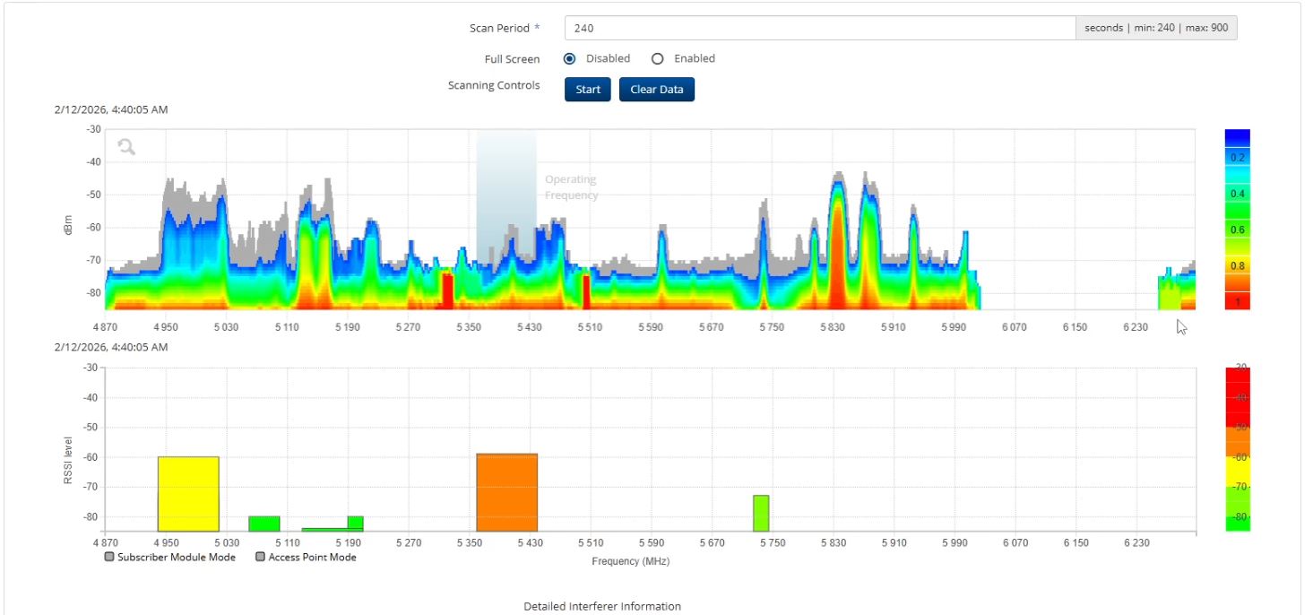

There’s really only two things you can do to reduce retransmissions, latency/jitter… reduce channel width and/or find a less noisy channel. You might also be able to get a bit better latency/jitter by locking the maximum MCS rate on both radios to whatever the highest % MCS rate is (e.g, looks like MCS7 on downlink side, and MCS8 on uplink side). You could also try changing to a long or short guard interval on the AP.
Changing channel and channel width can only be done by ISP so I have limited options.

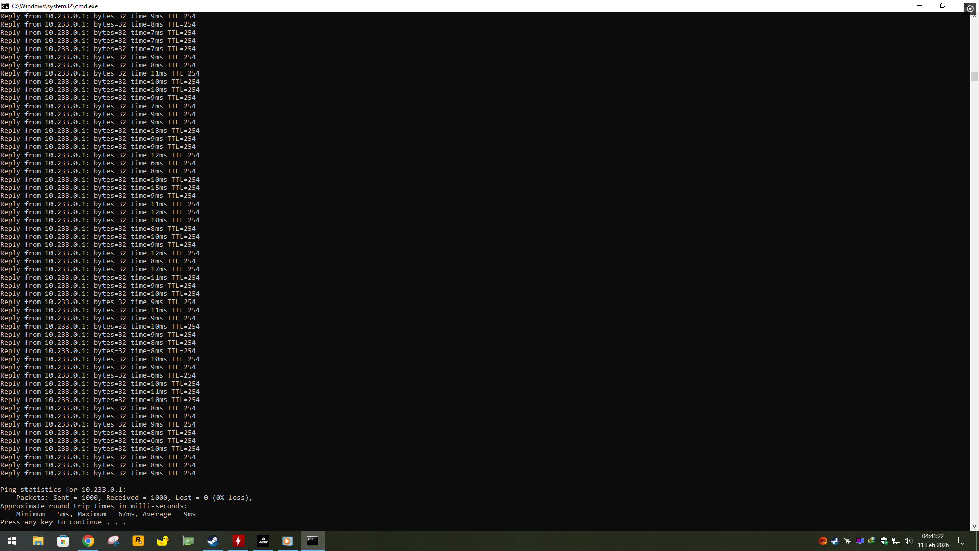

I am experiencing high ping and ping spikes while gaming more especially from 15:00 to 18:00
the downlink locks itself to DS MCS 2 - QPSK 3/4 during that period.
The Link Quality Flactuates Every 5 Seconds And Drops Down To 49% Or Even Worse 20%
Then you will need to get your ISP involved, or find a new ISP.

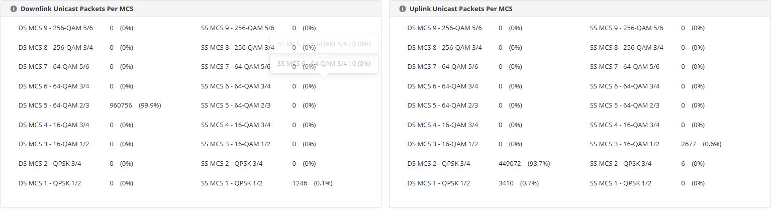

Seems Like The Only Way To Stop This Is Limiting Downlink To DS MCS 5 - 64-QAM 2/3 And Uplink To DS MCS 3 - 16-QAM 1/2 That Way Jitter Is Around 5ms And Ping Is 18ms In Most Tests
Ive written about this before, and youre right. Do not listen to those telling you tonreduce channel width or lock mcs to highest rate - this is the worst thing to do. What you’ve done is exactly right, you need to lock the mcs rate to the lowest rate that has packets passing, accept the lowest rate of course. I tune every single coe radio this way and my latency is 10-20ms with zero packet loss and zero retransmits. At 80mhz you can still get over 100mbps at mcs2, and with uplink set at mcs3 you can get more than 25mbps.
You worked it out yourself, but its crazy ppl still think reducing channel width is helpful. I tell people with noise issues to increase width to 80mhz and fix max mcs lower and lower until theres zero retransmits. Reducing channel width is old thinking that is wrong with these radios, no matter how big Eric’s response is :grinning_face_with_smiling_eyes::victory_hand:
Exactly. This thing of locking mcs to the one which passes the most packets doesn’t work. Better to keep reducing mcs till 99% or 100% of packets pass at chosen mcs while also monitoring retransmissions and capacity drop packets.

I’ve been doing this for many years… both approaches—reducing channel width and/or adjusting the MCS—complement each other, and both are well-established techniques.
But what you’ve done is optimize the link and do the job right.
Every scenario is different, and while each technique improves links, I’m a proponent of being mindful of the spectrum (a scarce resource); so, if I don’t need 80 MHz, why use it?
