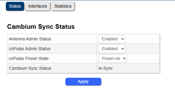

One thing to check, did you make sure that cnPulse admin status and power is enabled?
Hi Eric, thank you for your insight. I do have both enabled.
