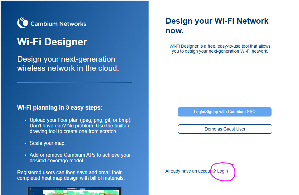

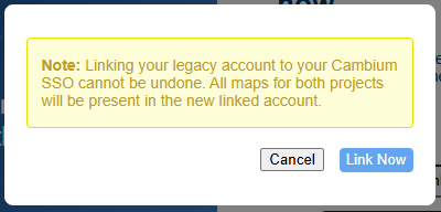

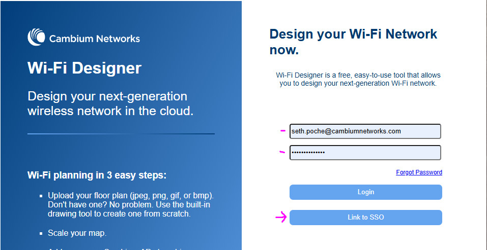

So logout of WiFi Designer. At the main sign-in page towards the bottom you will see a link that says “Already have a login?”. Click that link. Fill in your legacy credentials and click the “Link to SSO” button.All of your original maps will then be copied to your SSO profile. Let us know if that doesn’t work.
