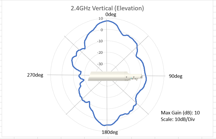

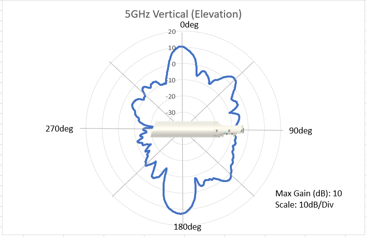

35 meters is quite high for an omnidirectional type antenna access point. The antenna pattern of the XV2-2T0 is:
we will be releasing a tilt bracket soon which could be used for the XV2-2T0, but our new XV2-2T1 (90/120deg sector) AP version will be more directional and designed for targeted coverage.
