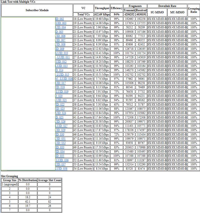

I've just been chatting with a US WISP who has allowed me to share the Link Test results they have in a 20MHz channel, 75% DL, 3 mile range and 4 contention slots. They hope to get around 150 SMs (from 36 now) on here in the near future. This might just squeak in as the best on 20MHz so far. Good grouping being seen.
Hello Andy, this throughput looks pretty good:

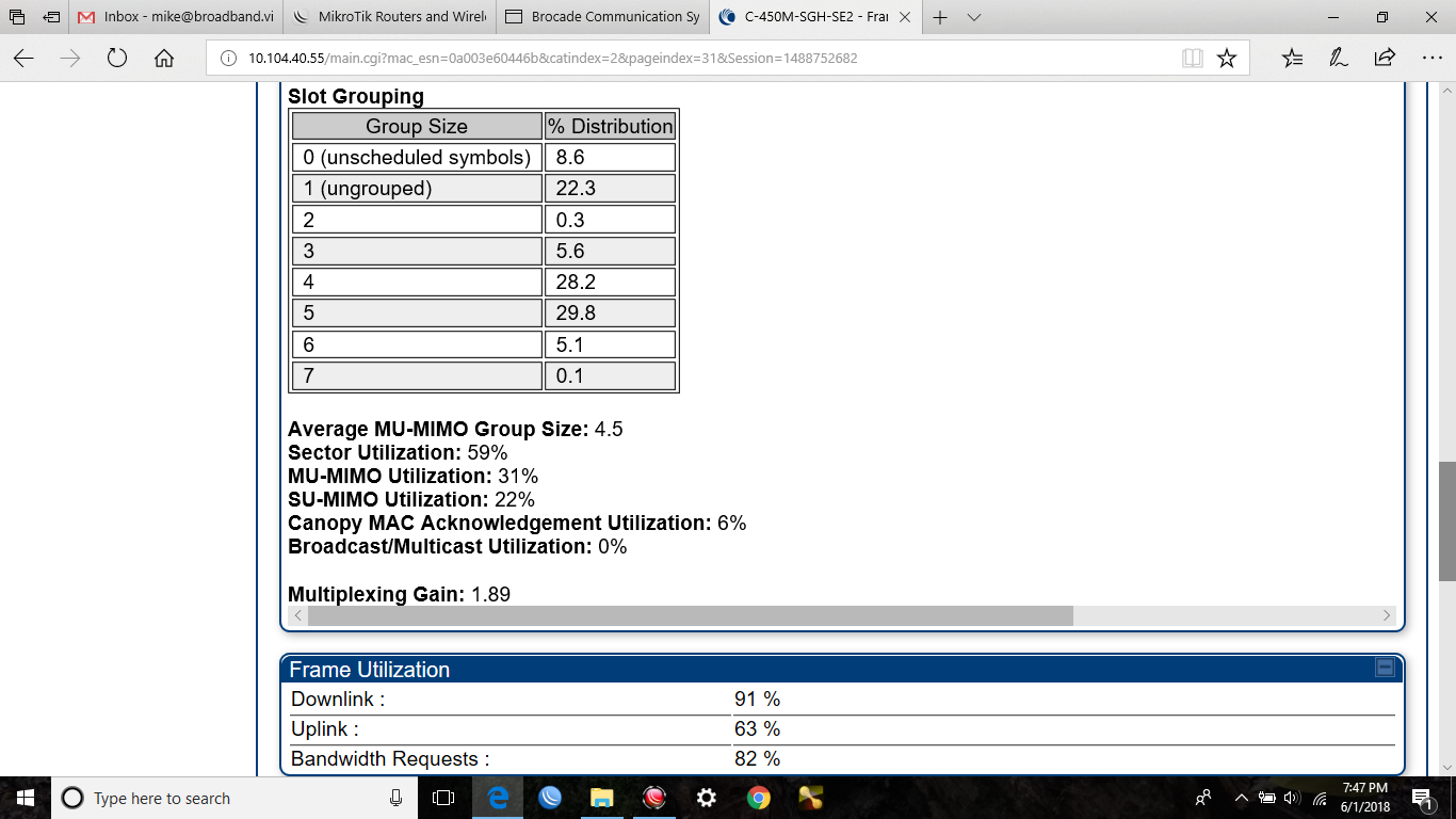

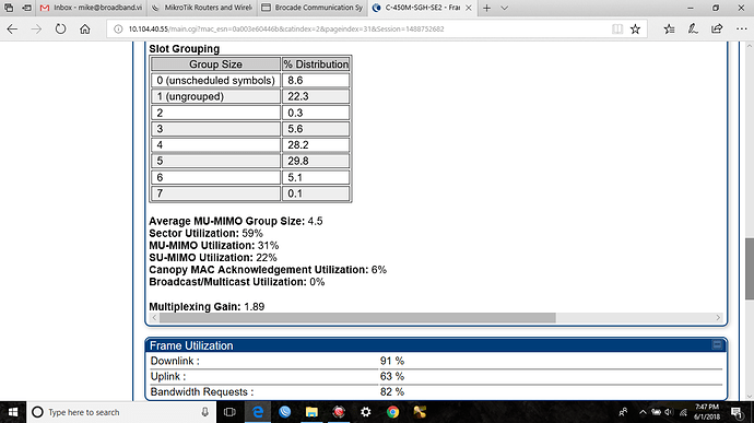

We loaded up an AP with 200 customers in a 40Mhz channel (it usually has 120 customers, moved SM's from adjoining AP's for the test....a very busy tower).
233Mbps average throughput with spikes over 400Mbps.
80% CPU utilization (a feature of 15.1.5)
Steady ping times, still able to do 25Mbps speed tests.
Customers are mostly on a 5Mbps plan, but 25% on a 25Mbps plan.
Awesome Mike... it would be interesting to know if all of those "ungrouped" guys are having high priority traffic, or if they could be persuaded into groups to further improve your results.
@CambiumMatt wrote:Awesome Mike... it would be interesting to know if all of those "ungrouped" guys are having high priority traffic, or if they could be persuaded into groups to further improve your results.
Matt, I don't know how to persuade SM's into groups. We are very excited about these results and are going to keep the AP at 200 customers for further evaluation. Bumping up customer speeds is on our agenda in the next few weeks.
Hi Michael,
Thanks for showing us these results, very promising.
Matt, note the grouping picture that Michael shared is from the Frame Utilization page, NOT the Link test to Multiple VCs. This means that group of one is perfectly acceptable in this case as the AP is not running anywhere near full sector/MUMIMO capacity, so some VCs will be serviced in SUMIMO mode.
If a Link test to Mutiple VCs is done and still shows a significant proportion in groups of one that would be more worrying/interesting (unless they are assigned as HP and not allowed to form groups).
Not the first time these two tables have caused a bit of confusion (even in this thread !)

2.7% ungrouped on the multi-VC link test.
281Mbps with 92% efficiency, with 250Mbps of traffic flowing.
So I'm assuming 531Mbps total capacity.
Hi Michael,
We think it's possible the CIR settings may be hampering the link test result, you said most SMs were limited to 5Mbps. Upcoming releases will allow the link test to ignore CIR settings (via radio button).
Could you share the field_diags.cgi from the unit to help us understand the setup ?
