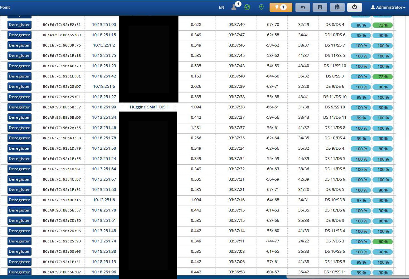

The upload bandwidth rates are definitely much lower than download, even with 50/50 scheduling.
At the point in time that I got this screen capture, it DS9/DS9 with which I’m testing. However, I noticed that the upload DS number is varying quite a bit, on most (if not all) of the SMs, even on SMs where the upload RSSI is pretty strong, whereas the download DS numbers seem to be more stable.
Yeah, all your UL links are worse than your DL - and 9 of them are SS modulations… which is a problem. :folded_hands:
And they change rather quickly as I watch them. They aren’t stable at all.
But, even for those that are DS and good, the upload is still just a fraction of what the download is.
That’s almost certainly noise at your tower end. Have you got other APs nearby on the same frequency?
No nearby APs on the same frequency.
What you’re seeing is actually normal.
The MCS values aren’t static. They’re most meaningful when traffic is actively flowing because the radios are constantly adapting to current RF conditions. When a link is idle, you’ll often see the displayed MCS drop or fluctuate, then jump back up as soon as data starts passing. That’s expected behavior and, by itself, isn’t an indication of a problem.
As for scheduling, 50/50 and Flexible behave very differently.
With 50/50, the AP reserves half of the airtime for downlink and half for uplink, regardless of whether either direction actually needs it. This provides predictable performance in both directions, but it also means unused airtime in one direction can’t always be borrowed by the other.
Flexible scheduling, on the other hand, dynamically allocates airtime based on demand. If there’s significantly more upload traffic than download traffic, the AP can devote most of its airtime to uploads, allowing more than 50% of the available airtime to be allocated to uplink whenever demand requires it. If download demand is higher, it’ll shift airtime the other way. The result is better overall efficiency and typically higher peak throughput because airtime isn’t wasted. An example might be that one moment the scheduler is allocating approximately 95% of the airtime to downlink and 5% to uplink. As traffic patterns change, it may shift to 40/60, then later to 10/90. The exact ratio is constantly adjusted based on current demand, allowing the scheduler to make the most efficient use of the available airtime.
Keep in mind that all SMs on the AP share the available airtime. If multiple subscribers are simultaneously pushing large uploads, they’re all competing for that same uplink airtime, so each customer will naturally see lower throughput than if they were the only one transmitting.
In general, Flexible is the preferred scheduling mode whenever you can use it. The main exception is when you’re running GPS synchronization with other APs or have another reason that requires a fixed frame structure. Otherwise, Flexible makes the best use of the available airtime and will generally deliver the highest aggregate throughput while still allowing the scheduler to fully utilize both uplink and downlink whenever demand exists.
