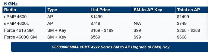

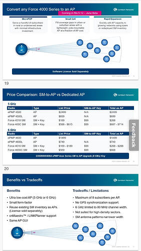

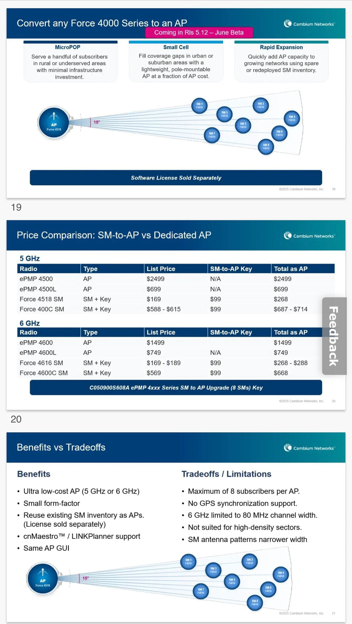

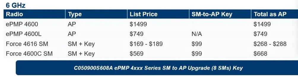

Does the 8 client limitation also apply to the 4600C, as the C is apparently the same hardware as the L?
I really need to get my hands on the 4600L but in my part of the world it is very difficult to get that model while the 4600C is everywhere.
Yes, the 8 client limitation (and other stated limitations) apply. If you need a full 4600L with all features, you will need to buy a full 4600L. If you review the price comparison chart I posted, you’ll notice that the cost of the full 4600L is slightly more then the cost of the 4600C + limited AP license.
