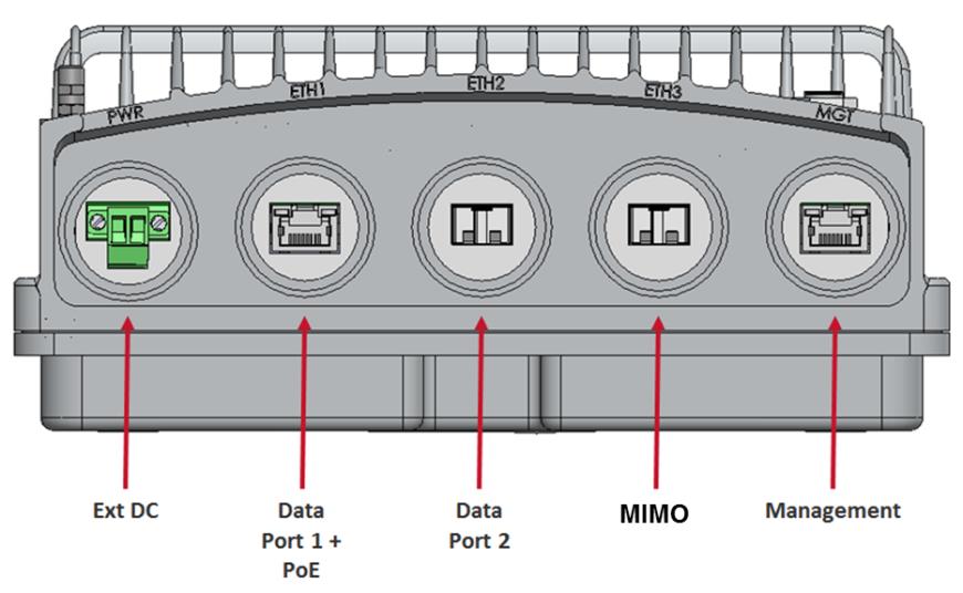

A summary of using PTP820C for 2+0 link configuration for over 1 Gpbs configuration, you will need two cables per radio in order to achieve over 1 Gpbs, as per port is limited to 1 Gbps.
  • Enabled 2nd GigE port on PTP820C (PTP 820 Act.Key - GE port is needed)
  • Enabled 2nd Core on PTP820C (PTP 820C Act.Key - 2nd Core Activation is needed)
  • Use 500Mbps or 650Mbps capacity key (PTP 820C Act.Key - Capacity 500M with ACM Enabled or PTP 820C Act.Key - Capacity 650M with ACM Enabled)
  • Add 2 additional SFPs and cables
During the configuration, you can go with either a multiple P2P service or a single PMP services, either way works.

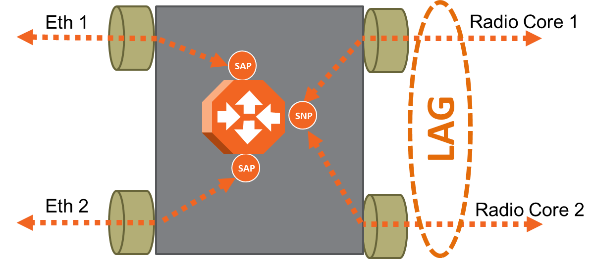

Configuration 1 – single MP service with LAG
  • Two radio core are configured as a LAG group 1
  • One MP Ethernet services need setup
    • SAP –Eth 1 & SAP – Eth 2 <-> SNP Group 1 (LAG of Radio core 1 and 2)
    • Multipoint services are used to provide connectivity between two or more service points.
    • When traffic ingresses via one SAP (Service Access Point), it is directed to the SNP (Service Network Points) in the service, other than the ingress service point, according to ingress and egress tunneling rules, and based on the learning and forwarding mechanism.

  1. Configuration 2 – multiple P2P services, no LAG
  • Two P2P Ethernet services need setup
    • SAP - Eth 1 <-> SNP Radio Core 1
    • SAP - Eth 2 <-> SNP Radio Core 2
    • Point-to-point services are used to provide connectivity between two interfaces of the network element.
    • When traffic ingresses via one side of the service, it is immediately directed to the other side according to ingress and egress tunneling rules.

Can you use  the second SFP port to achieve this as well?
The second SFP on the PTP820C is used for MIMO data-sharing. So, in normal PTP820C, you cannot use it unless you make a special order from Cambium.
