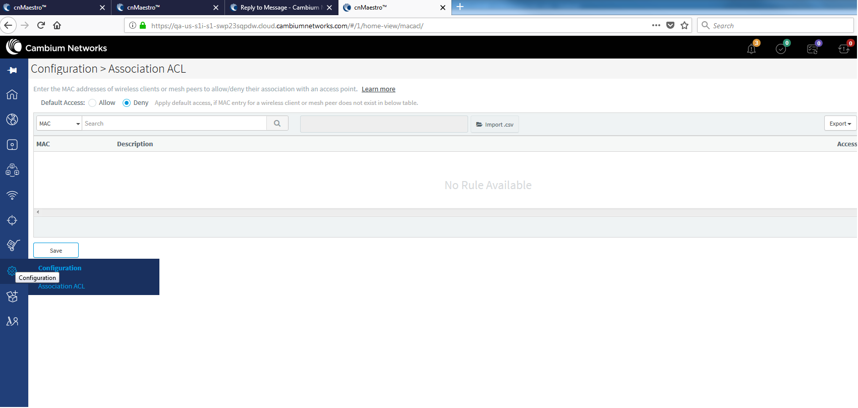

I already set Default Access/Deny as well as my handphone MAC address Deny, but I can still connect my handphone
YOU DON’T NEED TO DENY YOUR MAC SEPARATELY. DEFAULT DENY WILL AUTOMATICALLY DENY ANY MAC WHICH IS NOT LISTED ON THE ACL. PLEASE REMOVE YOUR MAC FROM THE LIST LEAVING THE ALLOWED MAC. EVEN IF YOU LEAVE YOUR WI-FI NETWORK OPEN USER OUTSIDE THE LIST WILL NOT BE ABLE TO ASSOCIATE WITH YOU WLAN.
MOREOVER, IS YOU AP SYNC WITH THE CONTROLLER? OTHERWISE THE ACL WILL NOT BE APPLIED ON THE INCOMING ASSOCIATION REQUEST TO THE AP.

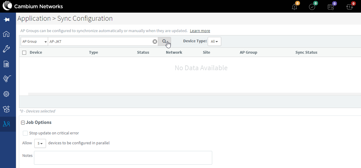

No sync error shown on top right window but I can't see my AP Group name in Sync Configuration
