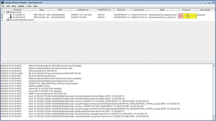

Step 1- Please click on Edit – Add Elements to Network Root
Step 2- Use the Default/Inherit settings if there are no changes to the SNMP settings. If there are configuration changes on the radio, you need to make changes to the highlighted parameters-
Step 3- Go to View and Refresh/Discover the Entire Network. The Access Point gets added to the Network Root and the Subscriber Modules associated are automatically discovered.
Step 4- To upgrade the Subscriber Module, the Subscriber Module needs to be moved under the Network Root. Go to View and Refresh/Discover the Entire Network.
Step 5- Go to Update and upgrade the selected Network Elements.
The radio has been upgraded to the latest firmware.
